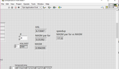

We need to see how you are testing.
The front panel in your picture is completely meaningless (you don't even show all dimensions). And no, a hyper-threaded core (= 2 virtual cores) does not give a 2x speedup over a non-hyper-threaded code. You have four hyperthread cores, so 4x speedup over a single core is about what you can expect.
What functions are you testing? The masm functions operate on matrices directly, so why do you even need a loop? What are you doing with it? How is the parallel FOR loop configured? What are the execution properties of the testing VI? How do you measure the execution time?
this is CPU information ( 4 cores each of 2)
when p=1 and the # of thread =1 the result speedup is satisfied about 8,
when i change # thread keeping p=1, there is no change

Your math makes no sense.
Again, show us the diagram, not the front panel (best, attach the actual VI)

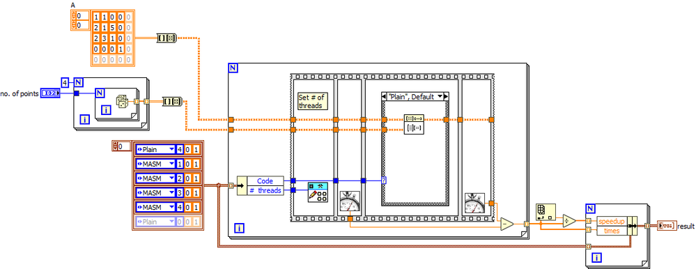

I'm going to install the MASM toolkit and do some tests, but as we discussed before you might not get as much speed increase because you only have so few rows. A multiplication of two matrices is not necessarily trivial to parallelize (start here) while other matrix operations possibly benefit more.
In the meantime, try to rewrite your benchmark code in a little more reasonable way and avoid all this duplicate code and that long worm of a sequence structure. Use a FOR loop with a case structure to do the various tests. Only the code that is different belongs inside the case structure, the rest can be shared. You don't need the repetition loops. Auto-index the elapsed times at the right boundary to create an array of times. This should all easily fit on a postcard! You also need to be very careful because your matrix function outputs are not wired to anything. The compiler could decide to eliminate the entire matrix multiplication as dead code (especially if you disable debugging). Why calculate a result if it is never used?? You should also convert the A array to a matrix datatype to avoid the coercion dots (probably makes no difference in performance, but still...).

 ok am trying to rewrite my code taking ur advice and tips in my account.
the repetition loops are used in NI example ( AxB performance benchmarks .vi) the small matrix size the higher iteration?!
@altenbach wrote:
your matrix function outputs are not wired to anything. Why calculate a result if it is never used??
this vi is just a sample only for test, actually in my complete work i need the result

@ssara wrote:
 ok am trying to rewrite my code taking ur advice and tips in my account.h
Here's something to get you started. (Sorry, I don't have a serious CPU here, will try on Monday). Compare the size with your code 😄 (fully scaleable, e.g. adding higher numbers of threads only requires changing a diagram constant!)
