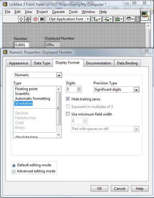

I'm not sure if it's available in 8.2, but try to set your display indicator to SI NOTATION (under DISPLAY format).
It will automatically append "m", "u", or "k" (or others) as necessary.

Accepted by topic author Yogesh9ic
Hi Yogesh,
when switching on "unit display" for indicators LabView will do the part of (SI-)unit scaling for you...
