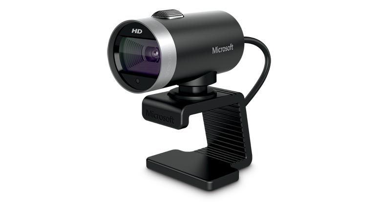

Thank you so much for your reply !
I tried with him a lot and took my time and did not Atousel the result.
I understand and work on it Vision Development Module but i have no information on OpenCV ,are there steps to follow to learn this property (OpenCV)?
What is important is the best way ?
Lifecam Cinema Camera
