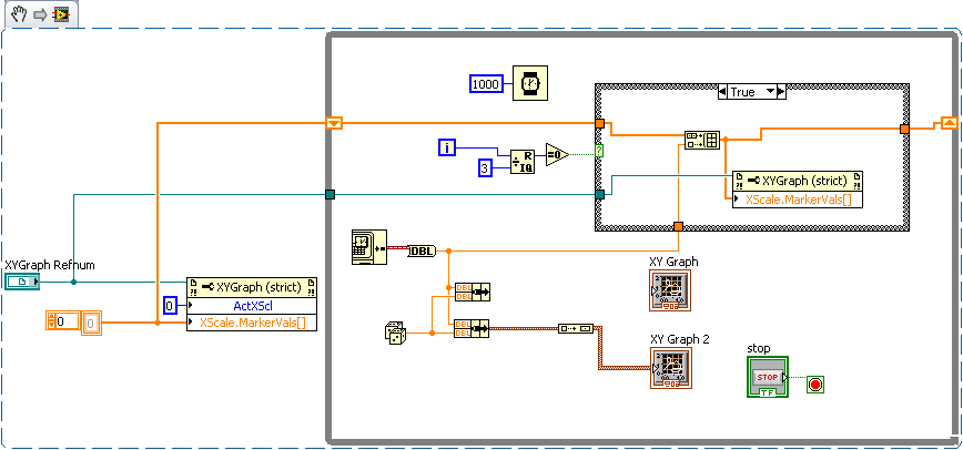

So I have tried building the the diagram you mentioned above but I continue to get Error 1055 LabVIEW: Object reference is invalid at the first property node.  Any ideas?

Sorry Matt!
Between the difference of a XY graph vs a Waveform Chart and throw in a bug with the VI Snippet not handling property nodes correctly, you were bound to have trouble.
This code is attached below as LV 2009.
Ben
(7,319 Views)
Thank you.  That did exactly what I was looking for.  I also like that I am able to control how often I am able to put a new hash mark at the bottom with this method.
