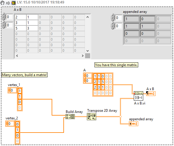

Ok, lets forget CUDA for a while, and lets only use the CPU first. As I understood, you want to multiply 1000 3-dimensional vectors with a single 3X3 matrix. What you could do, bundle the 1000 vectors (1D arrays in LabVIEW) into a 2D array, transpose it, finally multiply the single matrix with this 3X1000 sized matrix. The result matrix will contain the result vectors as columns. See this snippet below. So as I imagine, you could do the same with CUDA, and get the results with one step.
Edit: actually for 1000 such small vectors, you do not need CUDA...If you do not need to upscale this operation later, just use the CPU...
edit2: "these vectors are stored as a 3*1000 array." ok, so you already have the vertex matrix. So just multiply the 2 matrices, and you get the results in the columns...
