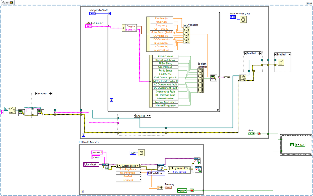

I have a project which requires data logging to a flash drive but it seems to cause a real-time memory leak (or let me know if there is a better term for this issue.)
Attached is a version of the data logging portion of my project to represent what I am trying to do. Basically take a cluster of data and write it to a file every so often. (I have a For Loop with a constant to simplify the code but in my actual project I use a Queue to buffer data and write-to-text-file every 10 seconds or so).
Now if you were to run the code and keep an eye on "FreePhysMem" you'll notice it decreases rather quickly. I need this system to run for at least a 24hrs.
If you enable all four Diagram Disable structures (which closes the file each loop) then the memory loss is significantly better. It still drops memory over time which I am not happy with but I'll tackle one issue at a time.

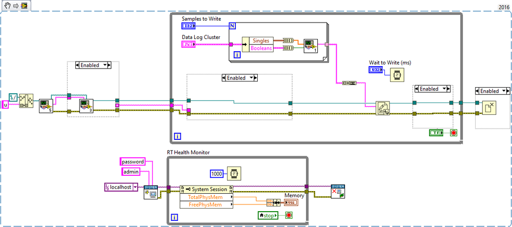

Made the changes with no improvement (except code readability which I appreciate).
For reference, "FreePhysMem" starts at about 135,000 and steadily drops to about 75,000 after 2 minutes. I updated the default values to demonstrate the memory effect.
New snippet and project zip attached.

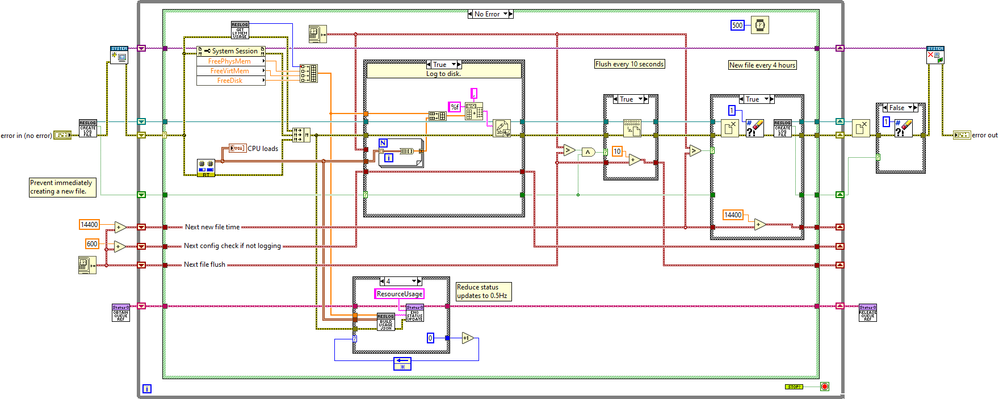

I feel like this isn't true... I'm running code that looks like the following on a cRIO-9045 (LabVIEW 2019) and it will happily run without losing memory (at least, that I've noticed)
This is a bit more "stuff" than is really necessary for this discussion, but you could completely ignore the bottom shift register and then you're left with something similar to what you seem to have:
  • Open a File, and "Initialize Session" before the loop (this happens once per cRIO restart for me - but the file opening VI is called again near the end of the loop)
  • Use "FreePhysMem" (along with a bunch of other data sources) to get resource usage
  • Convert to a string for logging, then use Write to Text File to log (the condition here is if logging is enabled and a file was opened, it can be configured to not log since it takes up physical disk space and if I'm not checking for anything, that just means I have to occasionally empty the cRIO disk so it doesn't get file errors from no hard-drive space)
  • Sometimes flush the file
  • Sometimes open a new file (Close File, Clear Error (the reference might not exist if the logging is not enabled - probably another case structure could avoid this, not sure why I chose the Clear Error, hmmm...), Create/Open/Replace File set to Create mode)
  • After the loop finishes (basically a global Stop button, usually not pressed) close the file.

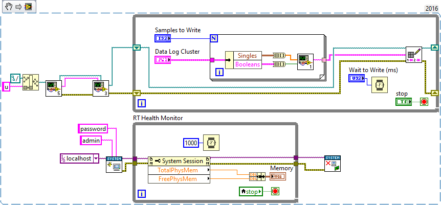

Hopefully I am not speaking too soon again but I found a solution.
I was using LabVIEW 2016 (on both the myRIO and computer) and after upgrading to 2019 the problem goes away.
This problem occurred on more than one myRIO with LV2016 installed so I know it isn't specific to a single myRIO.
This kind of solution isn't very satisfying but at least now it works.
