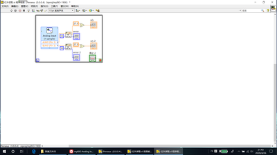

Sorry, I cannot upload the project because there are too many files, but I just used the program in this picture to read it. There is no other program. The sensor is Sharp's IR. The sensor power supply is additionally supplied.

I will not work with pictures.  I can't read the teeny-tiny print, I can't expand the Express VIs, I can't run the code on my own myRIO, etc.
Post your code!  Please.

I'm really sorry, this is my code, the same result has been tested just now, thank you for replying to me, this is my first time posting in the forum. thank you very much

I ran your IR routine on my own myRIO with nothing connected to any of the myRIO inputs.  A/AI0 showed changing values around 35, and B/AI0 showed changing values around 122, clearly different (and rapidly changing, hovering around these values).  Maybe I should plot it ...  Interesting -- if I plot the output, there is a large spike at the beginning (as high as several thousand) that quickly (I'd say 0.2 seconds) drops down to the 35 & 122 values.  Looks (to me) like the code might be working correctly ...
