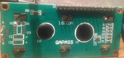

I hope you can help me with my problem, I just need the display shows me data, only that I need, I attached my model and display module.

Hi. The initialization command is described below and adopted from the LCD IC datasheet. It will work for 2 and 4 lines and you should see the data the you are writing to even on the screen if everything is working properly.
Are you getting an error if you probe it in the loop? did you check your LCD-backpack address and if it matches the one in the code that I sent you? And one final thing to check is whether the backpack is mounted in the reversed order to the screen. Good Luck.

Hello how are you doing?
Sorry to bother you again.
I did not succeed to connect the screen to Myrio
like you said, well check the module address I2C, and 0x27.
talbien set me on the settings screen, and does not give me results.
medi multimeter with continuity of the integrated circuit, and the pins are correct.
I could lend another Myrio of a classmate, because I thought mine was damaged, but also has the same problem of the screen.
acquired a mega arduino, and attach it as I made the first time, and I got the screen.
What advice can you give me? or will be wrong?
you think is the LCD screen?
Thank you so much.

Hi
Are you sure that you are using the proper I2C port and pins?
One last thing: double check the arduino code parameters that you have with the LabVIEW code if the above was properly connected.
