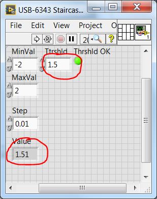

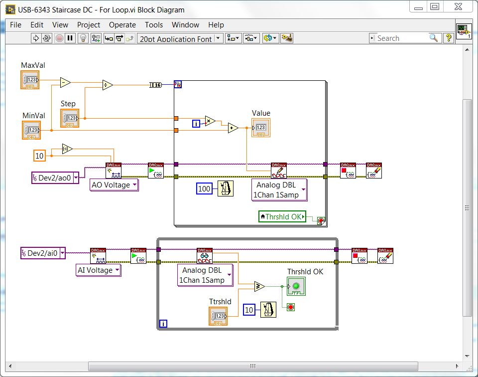

I've changed the approach - instead of waveform I generates staircase with DC values, incrementing in loop.
Such solution is even better for final application.
The objective remains the same - when reading value reach the threshold, output must be "frozen".
This setup works perfectly except small detail - the final value on output is 1.51V instead of 1.50V (as it supposed to be due to "MORE OR EQUAL" comparator).
What could be the reason of such imprecision ?
You have a race condition with the local variable where the variable is read before the output gets its new value.  Therefore the loop iterates again.  So you should use a Flat Sequence Structure to force the reading of the local variable to be after you output the value.
