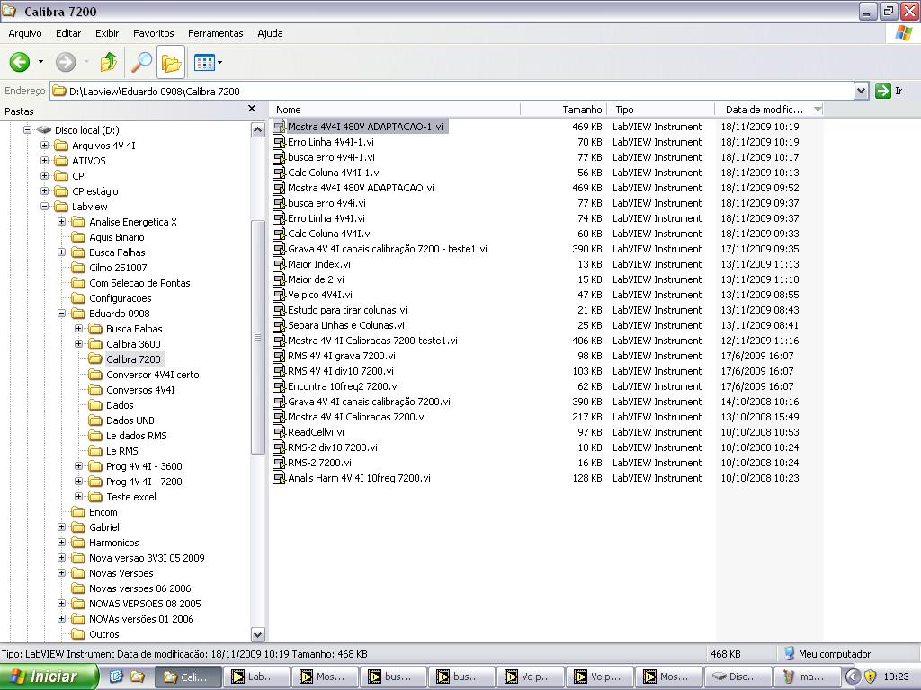

here, the file name:

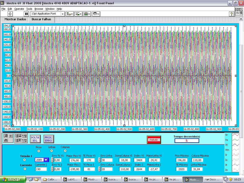

and here is the name that is appearing in front panel:
Now I want to know, how can I change the name is appearing in front panel!

I am assuming you want to change the name in the title bar.  IF you want a static name you can change the name in the properties, under Window Appearance.  Dyanmically, you can use a VI Property node to make it whatever you like.

ok guys, you answered my question!
Now I have one more, and I can remove the name in [] ?
like I want the title in front panel
appears only "show 4v4i"
Can I make that?
or the name of vi will always appear?
Message 6 of 9
(4,234 Views)
Name always appear when the VI is not running.
