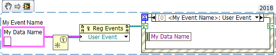

It depends on the name of the label you set to the data connected in the "user event data type" input of the Create User Event function and in your case, on the label of the refnum indicator in your action engine (Stop Application). If you make changes to the event name, you might have to re-create this indicator to see the correct names in the event structure. If you don't connect this directly to the Register For Events function but as part of a cluster, then the name of the cluster also appears in the Event Structure.

You can wrap the data in a cluster to distinguish the event name from the data name.
