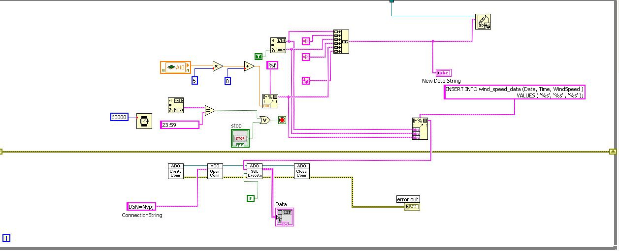

Hi mr Mike, the A,B,C just a testing only. Now i have change to as pic below.

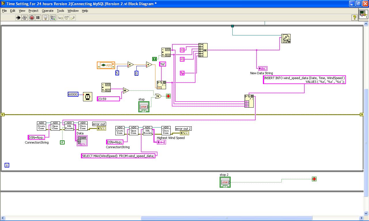

I got a question. Can i extract out the highest value in  wind speed column in mysql and show it on my front panel in labview ?

Yes, it's quite easy with the SELECT statement. Google is your friend. Simply search for SQL SELECT MAX. A basic SQL tutorial would be of great benefit to you.

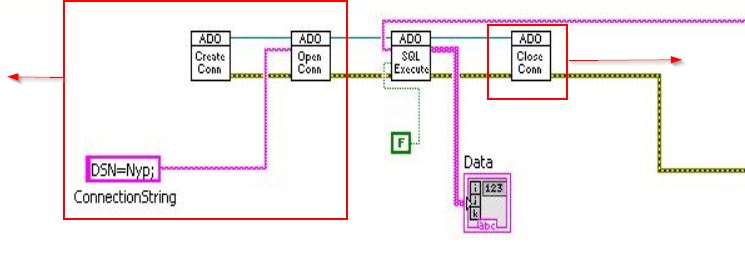

Now that things are starting to work for you, it's time to get the database Open and Close out of your While loop.  There's no reason to create/open/close the connection every time through the loop, is there?

Jim, if i remove ADO Open connection, The DSN=Nyp; link will dissapear, will it lose connection to mysql database ?
Now i added one more to show the Highest wind speed logged. And the connection is as pic below. Can i remove the ADO Open , and Close for both ? Program Pic.JPG
I didn't mean to remove it, just move it outside of your While loop so you're not creating/opening/closing it every time through the loop.  Here's what I meant:
