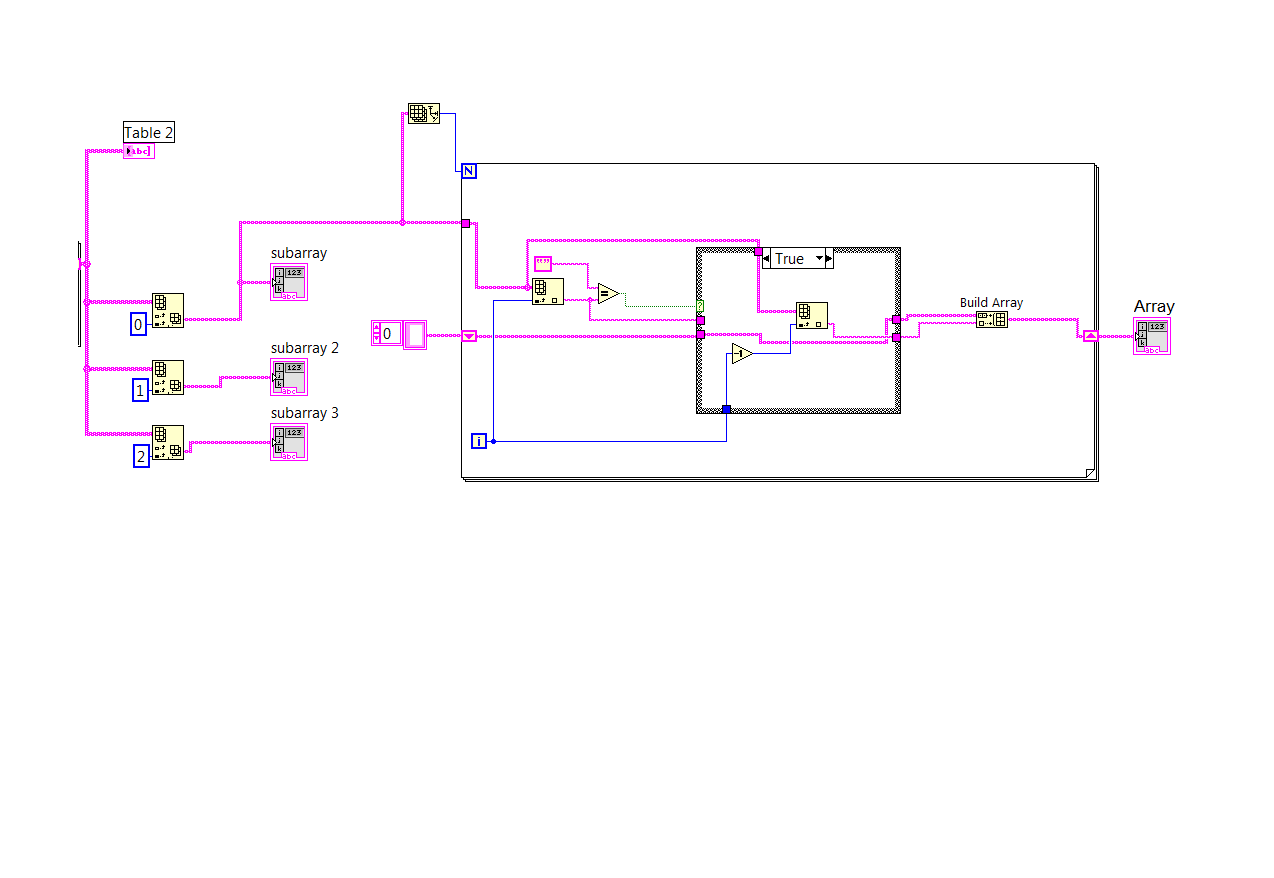

thanks for ur suggestion.
the problem with my program is that it will print element in next cell but not for the successive empty cells. I cant find out where the mistake lies.
(3,224 Views)
Check your program data flow.
Check this,
Munna
(3,219 Views)

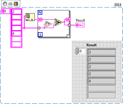

Hi ,
Try this.
Regards
