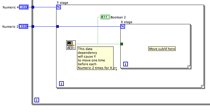

Put the VIs for the two controllers in parallel loops if you want them to run independently. If you always want X to run after Y, move the X loop outside the Y loop but feed numeric 2 through the Y loop to create a data dependency.

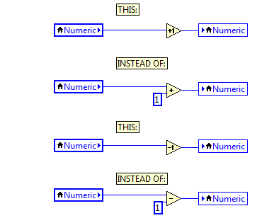

it would be helpful to post your VI....also,

A simple data dependency should create the pattern you want.
Lynn
