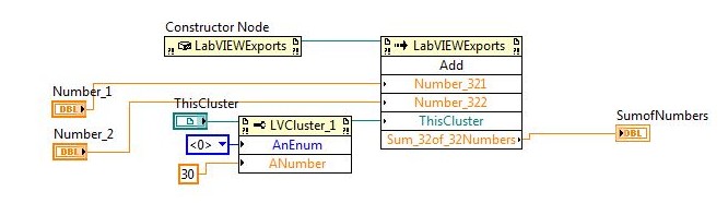

Problem:
When a reference control for a calling statement is created, LabVIEW is able to parse through the names correctly, but the Property Node ends up with a different name "LVCluster_1", as opposed to "ThisCluster".

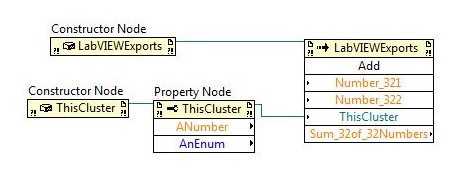

Solution:
Use a Constructor Node instead and select "ThisCluster" as the object. Now, when the propery/invoke nodes are created off of this reference, the appropriate naming convention now follows.
