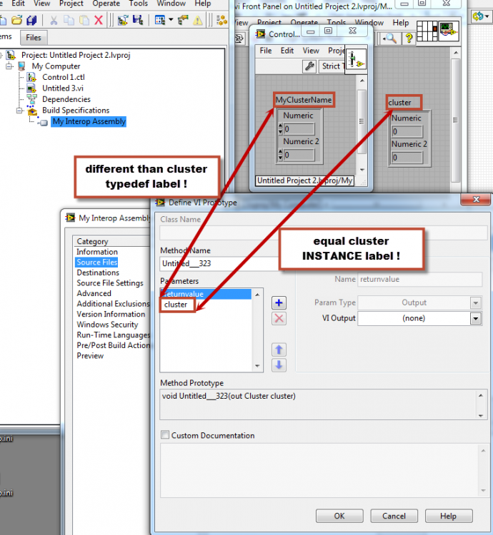

1st oddity: The documentation specify the following:
"Clusters and enumerations defined as type definitions or strict type definitions—LabVIEW uses the label of the type definition or strict type definition as the name of the .NET structure"
In reality I find that to be incorrect. Instead it used the typedef instance name. Am I missing something?
Note: I know I can rename it, but there are very good reason while I would love to have it worked as described in the documentation

Hi PJM_JKI,
On the subject of the first oddity, the “label” of a typedef actually refers to the instance - so the name of the .NET structure will refer to the specific instance of the typedef. If you're referring to the “name” of the typedef, the .NET structure does not take this on to preserve unique instances.
With regard to the second oddity, do the results differ when you use the LVInterop.shape.getBound command versus the LVInterop.Bound command?
Kristen M
Automated Test Product Marketing Engineer
(3,503 Views)
ok, if using the label of the typedef instance is the intended behavior I will suggest that the documentation need to be updated because it clearly seem to indicate that the label of the type definition will be used (and not the one of the instance).
