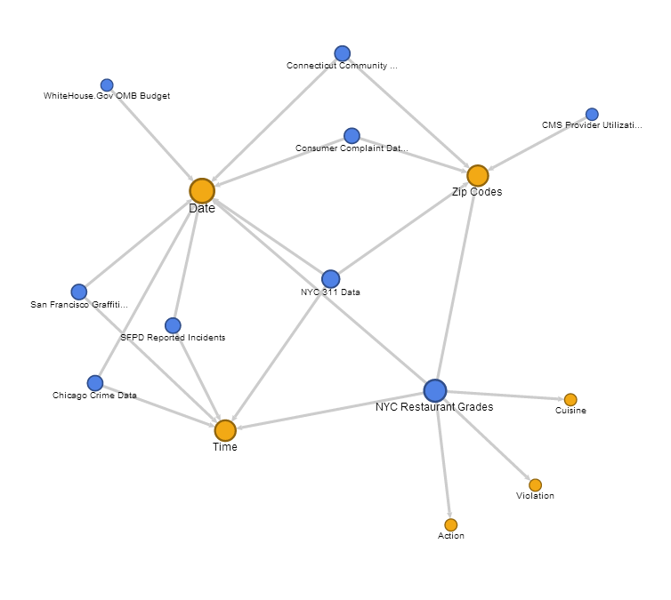

I've been able to get the free "NShape" library for .NET to work in LabVIEW:
https://github.com/dataweb-GmbH/NShape
It has bits of code in it specifically for drawing nodes, coloring them, attaching text labels, and linking between them.  The display control also has  zoom in and out built in as well.
It was a bit of a learning curve getting it to work the way I wanted, but the documentation is pretty good for free code (GPL license, so you can use it for free even for your business as long as you're not selling the software externally).
Here's a picture from the tutorial showing something it can draw:
There's an event you can register for that lets you detect when the user clicks on any node in the graph, if you want it to be interactive.
