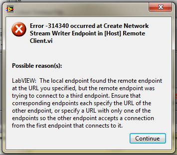

I have two network adaptor cards in my pc which i think is causing my problems when collecting data over the tcp.

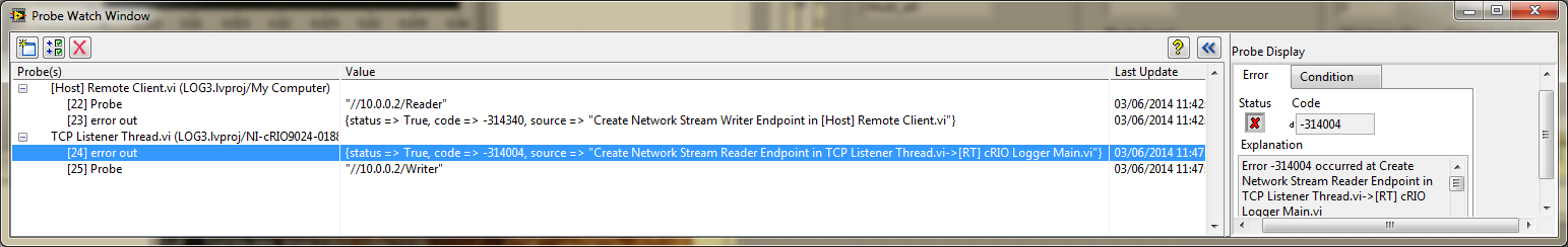

I'm seeing an error message -314340 from the create network stream write/read my address match up and i'm using a template crio vibration data logger. streamnetwork.png

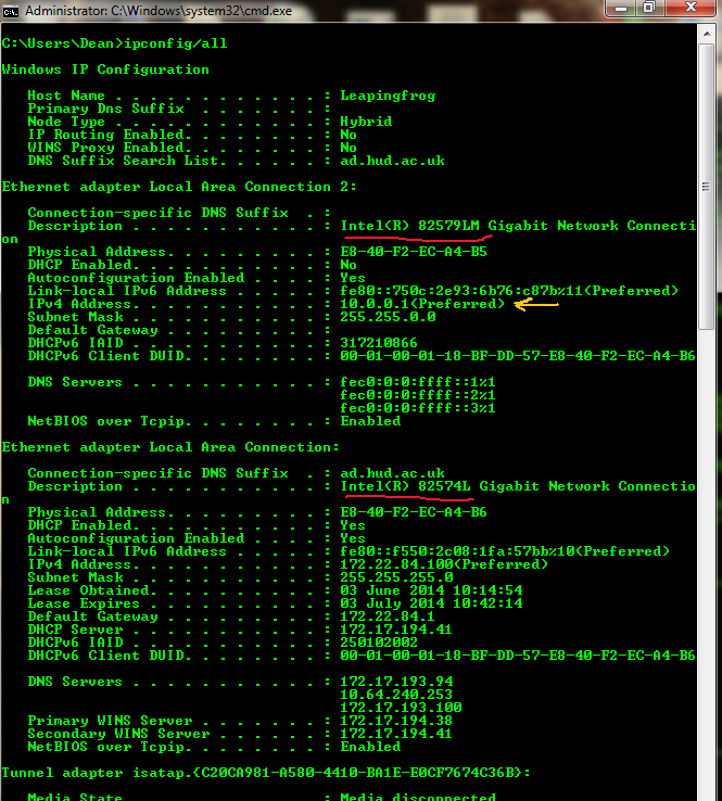

I have two network cards in my pc. I think the error is a tcp one and I’m wondering if this is causing the problem. I’ve given the crio a static ip address 10.0.0.2 with mask 255.255.0.0

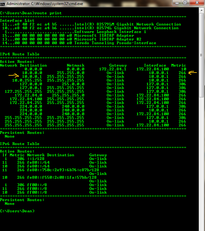

You can see the network adaptor below and it’s ip address 10.0.0.1 so I’m connected directly to this via ethernet cable. However from the Routes print cmd I don’t see the 10.0.0.2. Also the gateway for the crio is default at 0.0.0.0
Do I need to add the route to the list ? I found the cmd for that which I don’t think I’m using right… route ADD 10.0.0.2 MASK 255.255.0.0 10.0.0.1

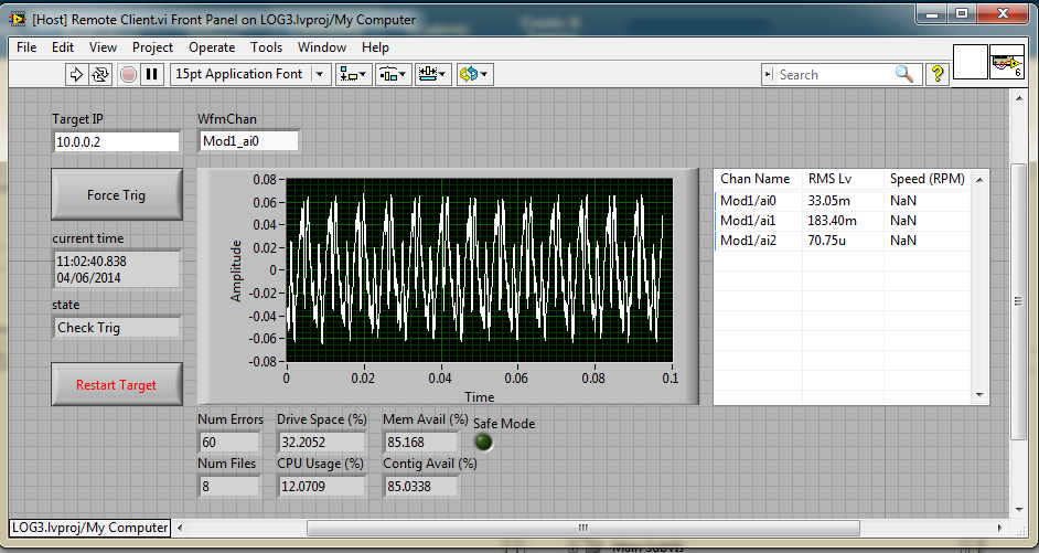

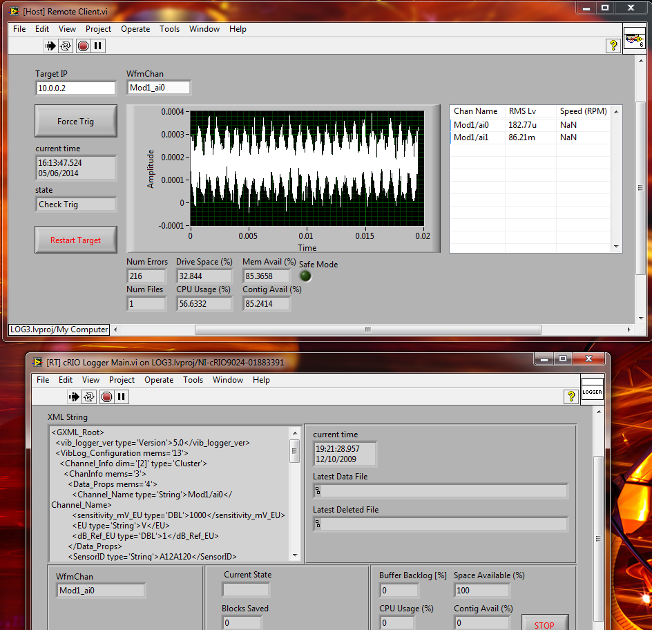

In the template example the ip was set the same for  Remote Client and cRIO Logger Main using the XML file. It was wrong, the PC ip address should go into the XML file and the crio ip address into the Remote Client.  So I’m able to start recording data see picture. After around 10 seconds the system crashes and I lose connection L

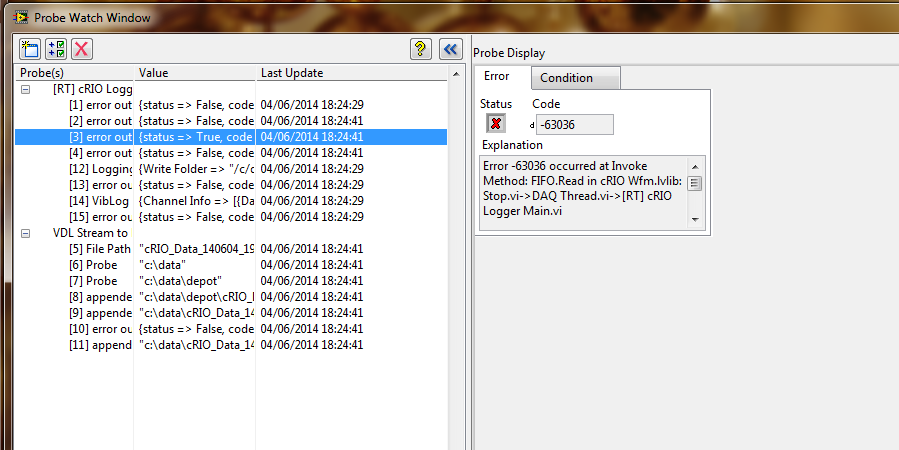

New error messages from probing around the code refers to the stream to disk class and fifo read, no idea whats happening do you have new suggestion ?
Error 1430 occurred at Move in VDL Stream to Disk.lvclass:Move File.vi->Logging Thread.vi->[RT] cRIO Logger Main.vi
Error -63036 occurred at Invoke Method: FIFO.Read in cRIO Wfm.lvlib:Stop.vi->DAQ Thread.vi->[RT] cRIO Logger Main.vi

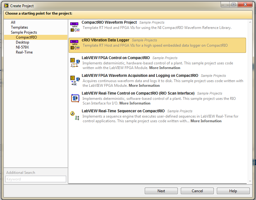

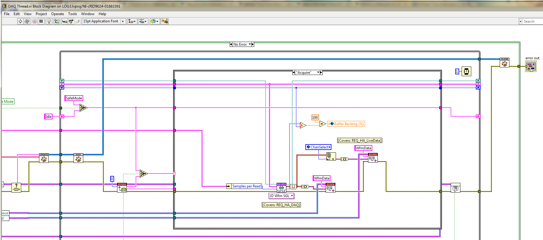

Hi i'm using the crio data logger template from the create project list:
I'll post my code and some pretty pictures to help explain myself 🙂
I'm using a different crio, so i created a new project and configured the FPGA vi for my hardware, then added the host side. I can run the code see the waveforms after 10 seconds it outright crashes and i've been searching through all the error messages tracking it back to some unfound reason. The irony is sometimes the program creates a tdms file and makes a deposit in the crio folder/deposit (this is defined from an xml file)
I do notice within a few seconds the cpu on the waveform panel increases to 70+% before crash, so i'm also thinking the FIFO read is at fault, but it could be another red heiring (just installing the real time exection package so i can trace this better).
I've changed the number of channels from the default 4 to 2 please look in the VibConfig.xml file to see the change as the [Host] Create Config XML.vi doesn't like to changing the channel from 4 for some reason.
My set up is [SENSORS] ==> [cRIO] ==ETHERNET==> [PC] Please help Cat Sad

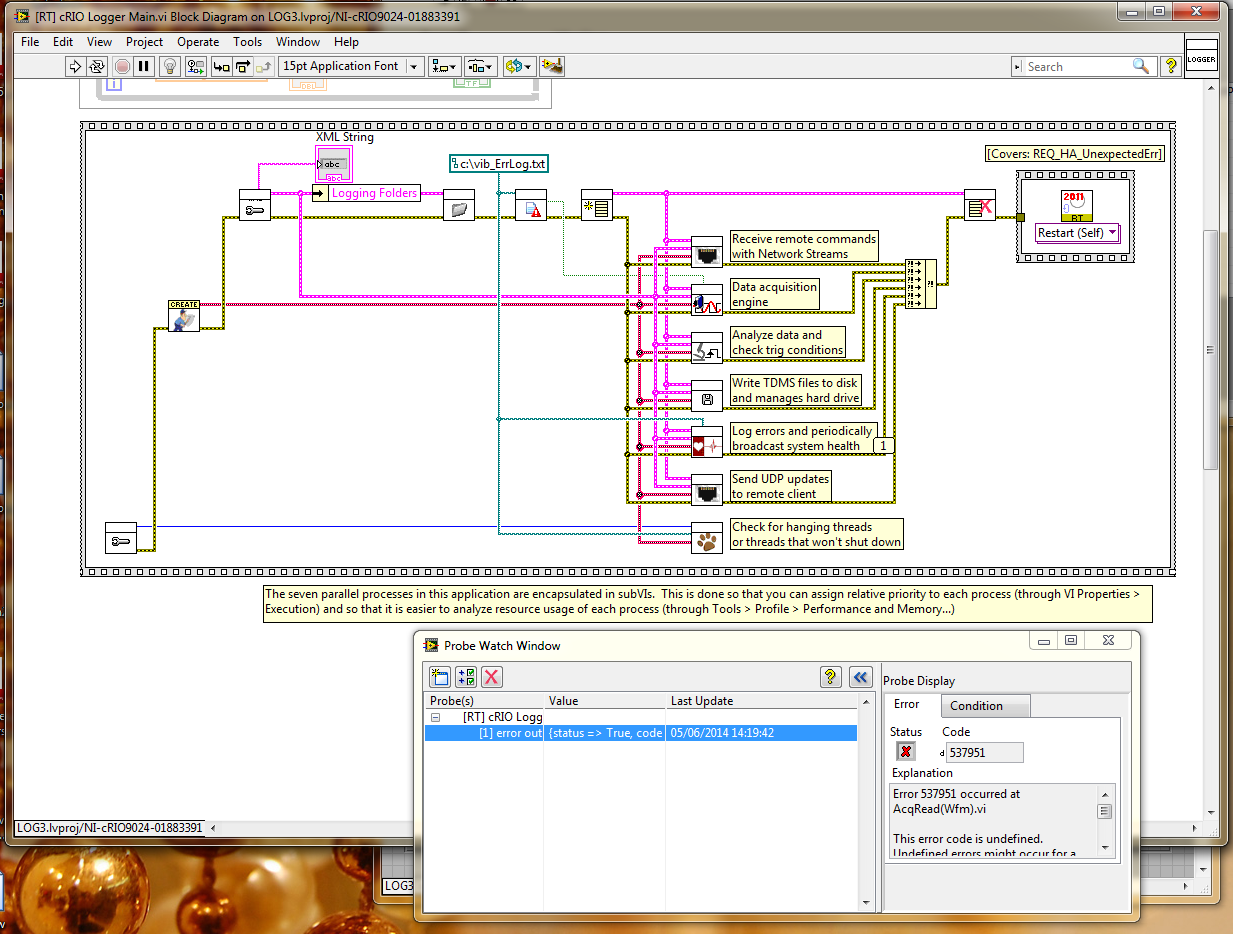

Here is my latest error, i'm not sure if this is the root of the probelms or the effect from another problem but the error message i can't find anything on Error 537951 occurred at AcqRead(Wfm).vi The probe is on the Health Thread.vi
Message 8 of 12
(5,107 Views)

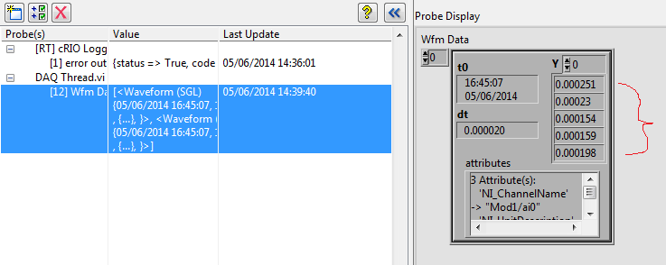

Ah, that error shows on a few values being written but then no value afterwards, could this imply the fifo read is max out therefore crashing the system ??? Smiley Indifferent
