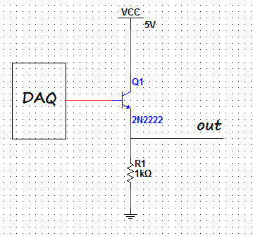

Hi abcdhi,
A power stage circuit can be as simple as the one I attach, you need to do this for each ouput from the DAQ device and plug it to a power source able to supply the power that the driver needs.
power stage
steve.bm
AE | NI
