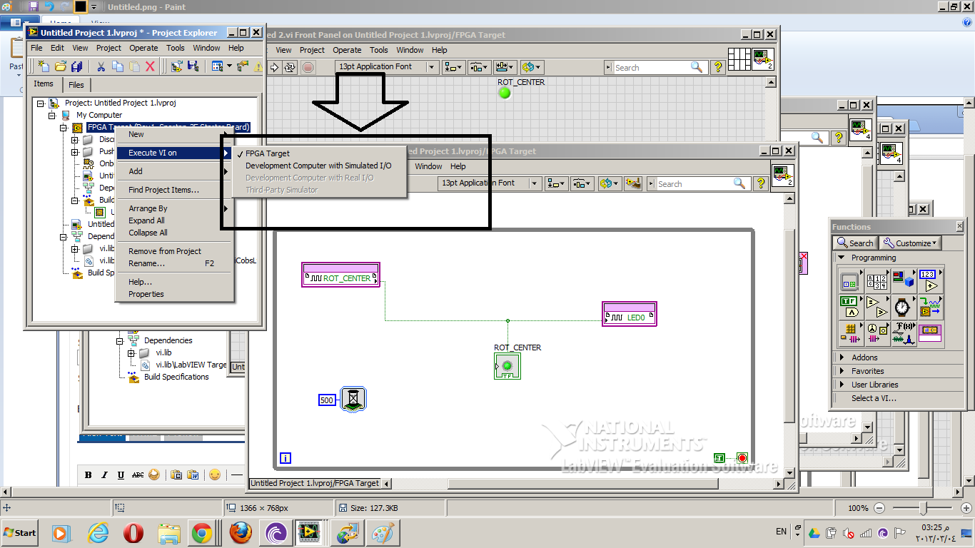

hi
i have two problem
you can see them in two figures
i did not  have a real time modul
are these problem related to this module
 regrds
hi ?Q>

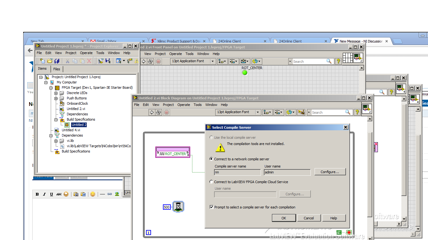

Hi mangood,
It looks like you don't have the Xilinx compile tools installed.  Take a look at the following KnowledgeBase to help you determine which tools to install.
KnowledgeBase 609GUVBT: Which Xilinx Compile Tools Do I Need to Compile My FPGA Code?
The Real Time Module shouldn't have anything to do with any of it. The give away was the message that said "The compilation tools are not installed."
Get that installed and see what happens.
