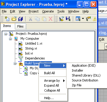

With LabVIEW professional installed, you should have the application builder. Something that could happen is that you have activated for example LabVIEW full which doesn’t include it. To check this go to Start>>All Programs>> National Instruments License Manager. If you see the Professional Development system in green then you should be able to create DLL.
I think that the confusion here more than in what version you have is the place of the Build tool. With LabVIEW 8.2 and later to build executables and DLLs you have to do it through the project.  Here in build specifications you have to select new>> DLL.
