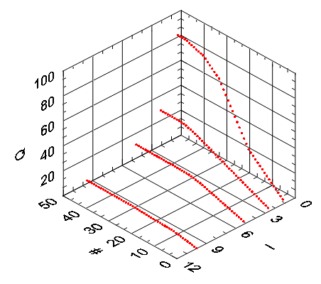

So, since x and y (I and t) are linearly related, we get four linear curves, each with a different slope. This cannot be fit to a complicated equation. 😉
There has to be something else! Here's a picture of the 3D data that could be fit if we had a model of Q(I,#).

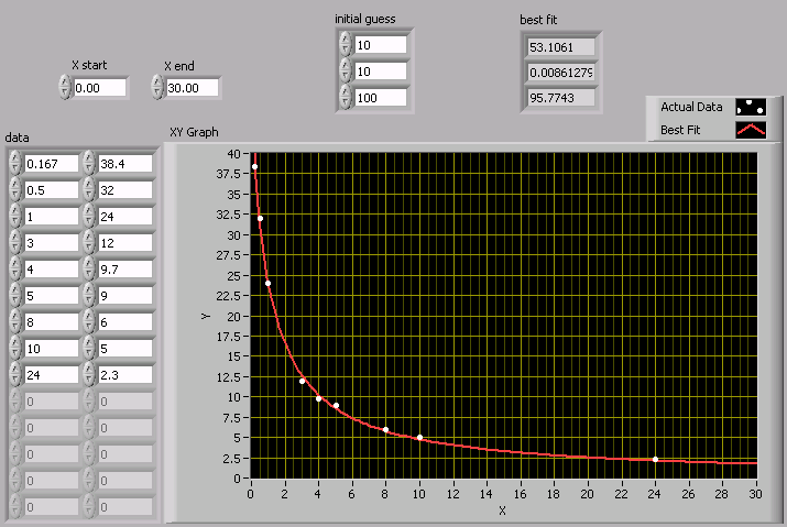

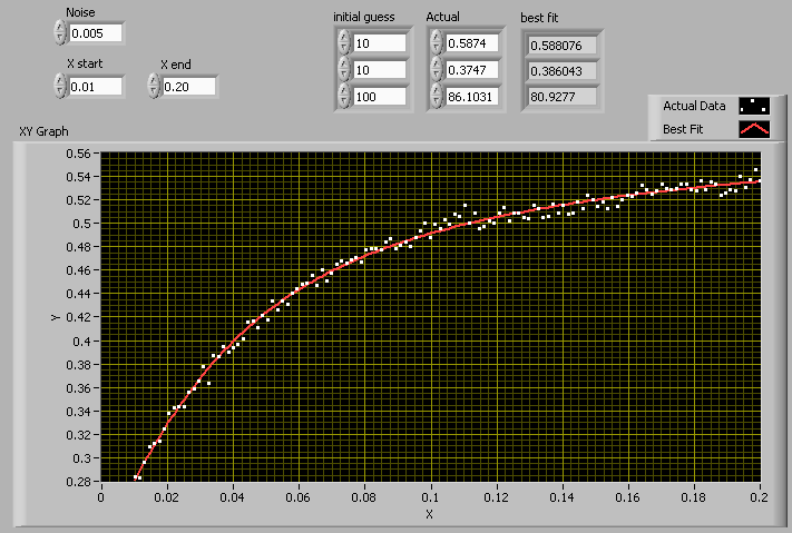

Here's what I did. I first use the model to simulate some data, the the fit succeeds well. (make sure that X cannot be zero).
(The result is only exact if there is no noise, of course)
Please double-ckeuch the model VI to make sure it is correct.
I still think you are misinterpreting your data.
