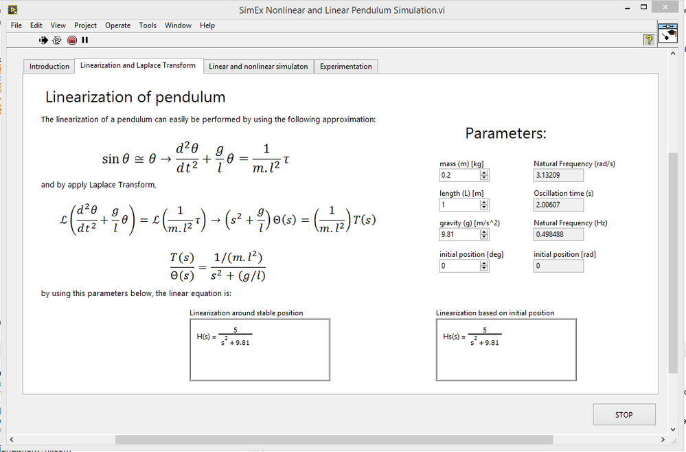

The best way to solve this equation is to use the "LabVIEW Control Design and Simulation Module (CDSiM)". If you have it installed, you can see a very good example in:
C:\Program Files (x86)\National Instruments\LabVIEW 2016\examples\Control and Simulation\Case Studies\Nonlinear\Pendulum\SimEx Nonlinear and Linear Pendulum Simulation.vi
This example, shows three different ways to obtain the State-Space and the transfer function of a pendulum. The key way to do that is using the "SIM Linearizer" function.
Hopefully this gives you the right direction to solve this exercise.

Hello shami_jadoon,
It looks like the example that Barp references is from the LabVIEW 2016 Control and Simulation examples. If you have the Module installed, you should be able to access the example by following his link.
Best of luck on your project!

That makes sense, however, I also have LabVIEW 2014 and the example is available with the toolkit installed. Examples have stayed fairly similar between LabVIEW versions since LabVIEW 2011. If you can't find it through example finder, I have also uploaded it here for your convenience.
