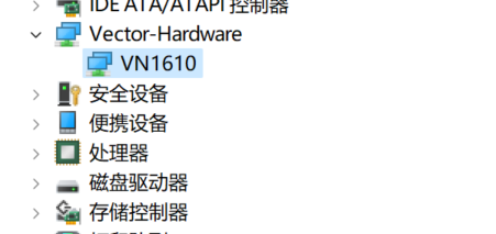

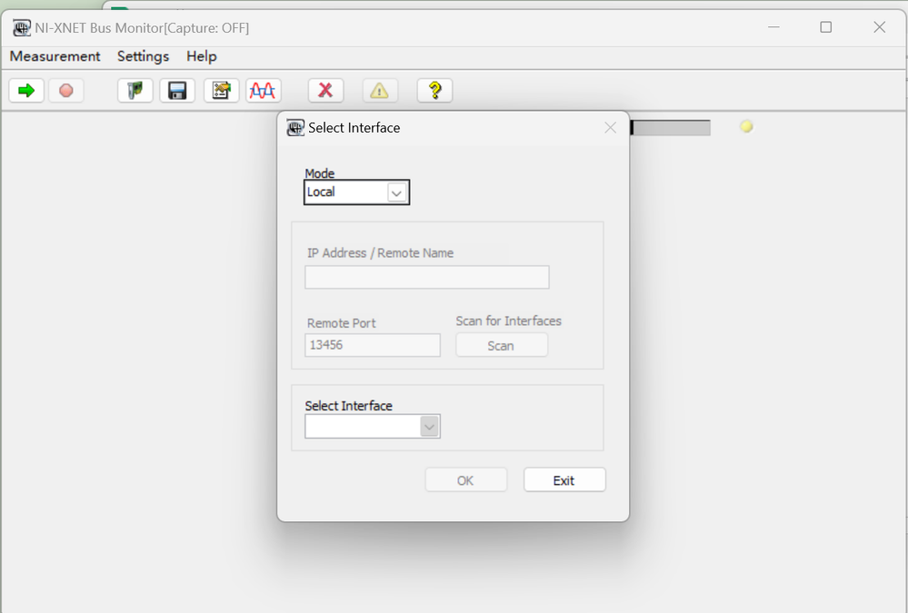

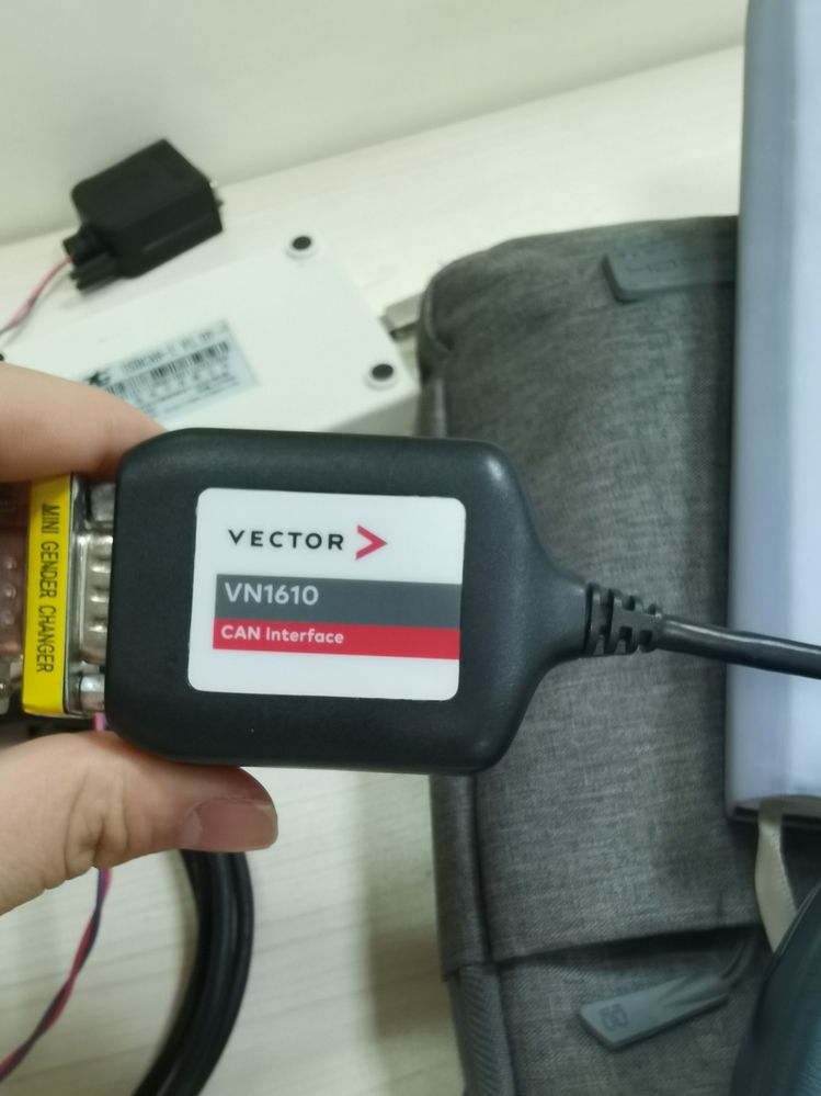

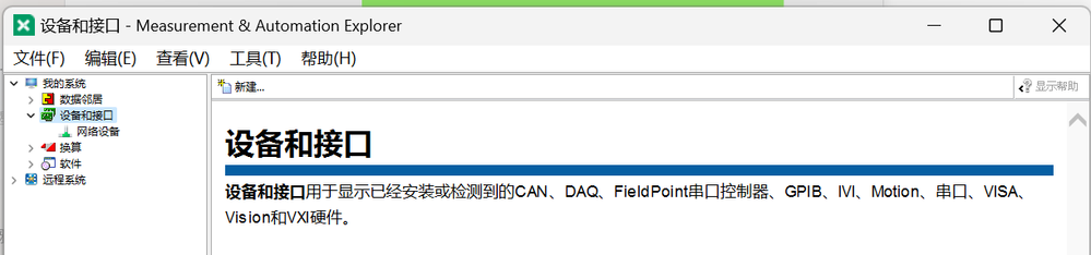

not able to see my VN1610 in MAX(Measurement Automation Exploerer)
I'm using add-ons "ECU M&C" to calibrate with the CCP protocol, but it tells me that there's not a valid interface. Therefore I found out though the VN1610-interface(produced by vector) in my PC task manager, it's not showing in MAX、NI-XNET and NI-MAX. I'm wondering wht's the cause and how to solve this problem.
VN1610 in Task ManagerVN1610 in Task ManagerEmpty Interface list in NI-MAXEmpty Interface list in NI-MAXEmpty Interface list in CANbusMonitor(NI-XNET)Empty Interface list in CANbusMonitor(NI-XNET)Device:VN1610Device:VN1610

As far as I'm aware, the hardware made by Vector (your VN1610 etc.) does not work with NI-XNET. Only the NI hardware will appear in NI MAX.
