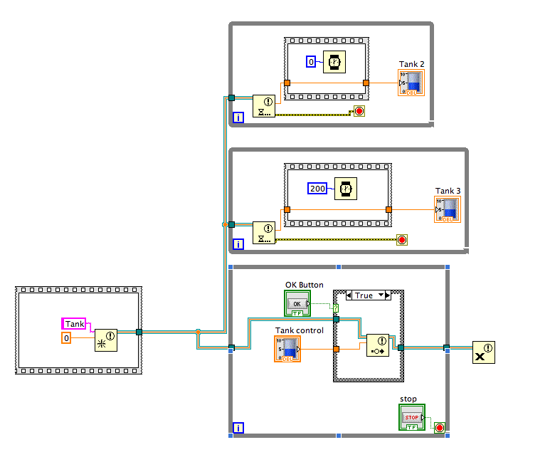

I can't keep my data after I press my stop button. I dont know how to fix it. I am using labview 2013.
Jack

Where should the data go?  Once the notifier is destroyed, all data it contains is also destroyed.  I think what you really want is to only update your tank values when you do not have an error (hint: use a case structure).

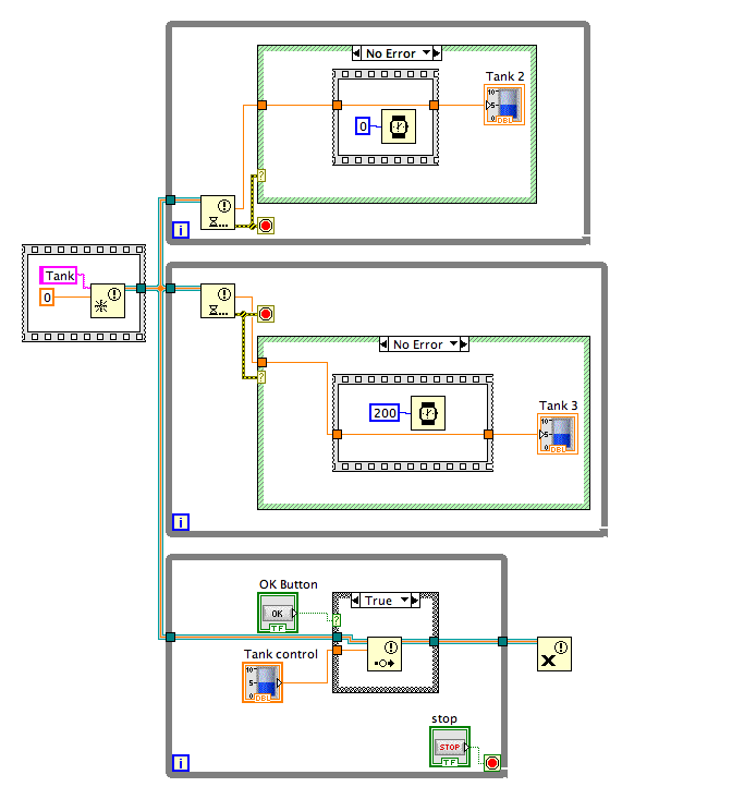

Thank you. I added a case for it.
