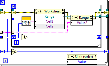

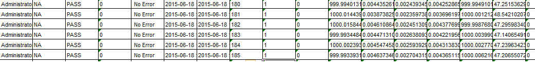

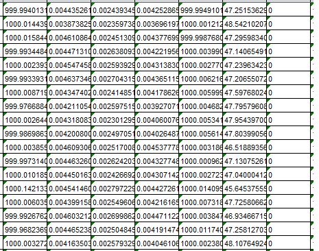

when write a table to MS Excel, the number all stored as text as you can see green flag on left top corner of each cell, this is cause the fomula in upper cell un-workable.
the code that used to write excel as below:
have you even seen this before? pls advice, thx!

Hi ELI,
so you write a string array to an Excel range - and now you wonder why those strings are displayed as strings? Really???
Write a 2D array of DBL when you want to store numbers in an Excel sheet…

Hi GerdW,
but the table also contained string like date/ operator name, only the test result is number (show in below).
Eli

Hi ELI,
and what's the problem then?
Write the strings as strings. Write the numbers as numbers. Handle them different!
(You might use even more ActiveX nodes to tell Excel on how to interpret each column of data. I don't think it will be easier this way.)

Accepted by topic author ELI2011
There's a hack you can use - after you write the values, read the data from the Value2 property and write what you just read back to the property (so it's write A, read B, write B). I don't know why, but this works. Probably some quirk in how Excel auto-formats types.

its amazing, and it really helped!
just read back then write it again, the error disappered.
