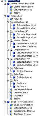

I finally came to a conclusion on this based on your suggestion.  Thanks for that by the way. I was willing to do some extra effort to get a better grasp of OOP, but it was nice to go down a better path.. I still have some questions, but a few of them are already answered for now.  I have attached the project9-15-2013 9-34-45 PM.jpg
