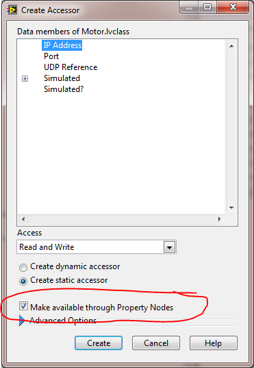

I typically create individual accessors for each individual item in my class private data. I then make these all available through property nodes (see screenshot). That way, when I am on the block diagram, using a property node, I have all of the options available. Even better is when I'm working with a class that is a descendent class of a different one - then the property node shows all data items (that you created accessors for), separated by lines to indicate which data items belong to which class.
It's fine to use a cluster. The only time I would create an accessor for a cluster is if I would be immediately using that data on whatever block diagram, as a cluster. My rule of thumb is basically, if I would be using an unbundle function immediately, then just create individual accessors. If you will take that cluster and pass it into something else, then create an accessor for the whole thing.
