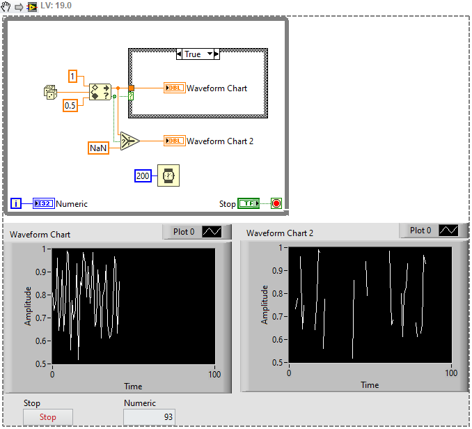

A combination of the previously mentioned In Range or Coerce function and the Case Structure would do what you want:
Here the first Chart has no gaps, but as a result the X axis doesn't really give "time" (or sample number, more accurately) anymore.
In the second, only the points between 0.5 and 1 are plotted, but the points that are below that are replaced with NaN (so gaps).
You can choose based on whichever suits your needs better.
