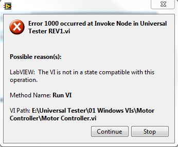

At what point is the error generated?

It comes in in the RunVI method.  Like I said before it is fine with highlight execution on but not off...

I modified it to say false now and I still get the same error.  I guess I didn't quite understand exactly what the "Auto Dispose Ref" function did.  So am I supposed to not close the reference inside the subVI?  I open a reference to itself to alter properties and methods and then close it at the end.

If you go back to the previous page and look at the code I originally posted, do you think the problem could stem from closing the reference betfore it's done running?  Because I call the subVI and set "Wait Until Done" to false so that the caller VI continues to run.  This subVI that comes up is like a notifier to tell the user something is loading and to wait.
If this could be the problem - what could I do to close the reference at the appropriate time (i.e., after the subVI finishes running).
Note:  I also removed the close reference VI from the subVI and still had the error.  The only close reference VI's are now in the caller.
