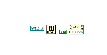

Use a property node and set the fp panel to open. See below
Tim
GHSP
Errr... that sounds like exactly what the user is already doing. The problem, as I read it, is that the subVI's front panel is being stripped when built into the executable, and they want to keep the front panel.

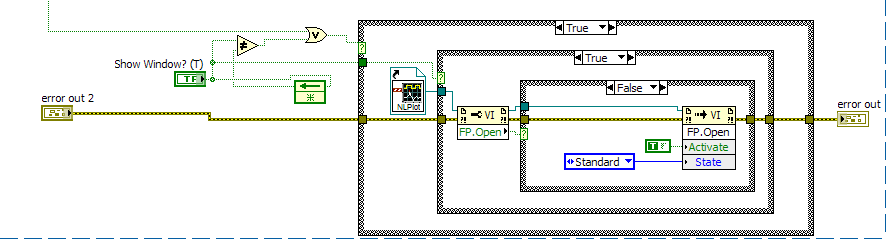

Have you tried using Static VI references instead of using "Open VI" with a file path?  With a Static VI reference, the compiler has a better idea on what you are trying to accomplish at runtime.
I have done that in executables before, w/o any problem.  I personally like to have a boolean input to the SubVI called "Show Window" (or something like that), and then have the SubVI handle how it wants to Open (or close) its Front Panel.
There is more than this going on.... the snippet kinda took liberties.
This is within the SubVI (which my Main VI is always running).  The SubVI contains a static reference to itself.  I have a button on my Main VI's front panel that when pressed sends a "True" to the "Show Window?" boolean input.  The SubVI responds by openning up the front pannel. The opposite happens when the button is depressed.
This code has been compiled in many executables and works w/o any problems.
Edit: Cropped image.  That boolean coming in is "First Call".  The LV 2009 snippet feature made that "error out 2" terminal.  Lol.  I wouldn't name it that.
Message Edited by Nickerbocker on 01-13-2010 10:30 AM
