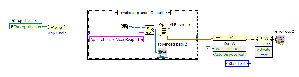

in my project i call a sub vi with open vi reference .
when i see the path it's right.
but i get this error :
Open VI Reference in main.vi<APPEND>
VI Path: <b>E:\electronic\project\abdipor\Tinsile Pc Software\94-5-24\build\Application.exe\loadReaport.vi</b>
Built Application or Shared Library (DLL): Make sure all dynamically loaded VIs were properly included in the build specification for the application or shared library.
LabVIEW Real-Time: VIs built into executables cannot be accessed through VI Server calls. Use Source Distributions to dynamically call VIs on Real-Time targets.

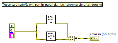

If you want to run a VI simultaneously, just put it on the block diagram:
The only main reasons to use Run VI or ACBR (call by reference) are either:
1) You want to call the VI dynamically, e.g. if you don't know which VI you want to run until run-time or to load it only when needed
2) You need to launch/run multiple instances of the same VI (perhaps at different times)
The Static VI reference will ALWAYS point to the correct VI path...whether it is inside an executable or in the development environment. If you move the project it doesn't matter, LabVIEW uses relative paths for most things (and every subVI should be on the same level or a sub-folder of the LabVIEW project file).

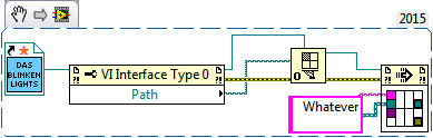

Can you post the non-working code so we can see it?
Because it should work as described:
If you do that, the "Path" output will be a disk reference in the IDE such as "C:\LabVIEW Code\blinkenlights.vi", but when you compile it, it comes out as a VI inside of the EXE such as "C:\Application\App.exe\blinkenlights.vi".
Wiring either of those into the "Open VI" node should work.  If that doesn't work, can you tell us the error number and text that come out of the "Open VI" node?
