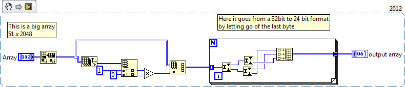

I have the following VI
It runs fast enough on a fast PC (duo core 2) but it doesn't run fast enough on my laptop. Is there a way to optimize this?

This is about ten times faster:
Polymorphism, especially for arrays, can be your friend.

Hi Thijs,
it's faster because:
- it uses polymorphism of the "Split Number" function to work directly on array data
- thus the compiler may use some SSE optimization (?)
- it doesn't use a BuildArray node as your version: the appending output tunnel of your FOR loop is nothing else than a shift register with a BuildArray node as was used for the purpose in older LV versions...

@GerdW wrote:
Hi Thijs,
I think that the main factor here is the avoidance of a Build Array node inside a loop by using the Interleave 1D Array node instead. Anything else might or might not add a few microseconds to the mix. Could be easily tested by removing the Build Array Node in the original VI and creating three 1D arrays on the loop boundary, then use Interleave 1D Array to combine them together. Certainly the speed difference is then much smaller and probably almost nihil.

Thank you to GerdW and rolfk for contributing explanations while I was sleeping.
