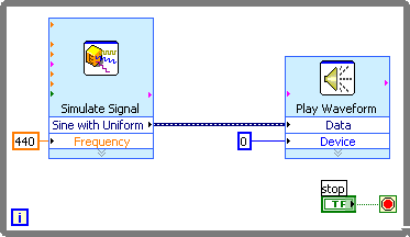

Hi! I'm trying to output a signal (e.g. 440Hz sine wave) to the computer sound card using the Waveform Generation VIs and the Simulate Signal Express VI as seen in the image below (taken from https://www.ni.com/docs/en-US/bundle/labview/page/sound-vis.html). However, I am unable to get a continuous sound output! The sound output has glitches/stops/interruptions. Is it because the sound stops after every loop? I'm not sure what's the problem! Please help. Thanks!!

The problem is the express VI. It is not designed to provide continuous sound output. In addition, you are generating a new waveform with each iteration. There will naturally be a break in the sound with each loop.
