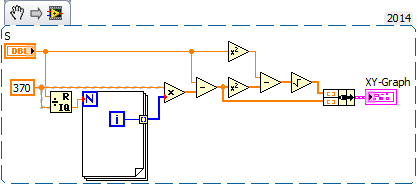

I thought it would be easier using a for loop in mathscript
Why do you need a Mathscript node to calculate a simple circle?
Why not use basic LabVIEW code? Why not employ polymorphism to get rid of loops as much as possible?
(Just following the formulas given in your PDF. Because of square and root functions it will only work for one quadrant.)

Hi Raul,
the problem is the data type of these two terminals are different.  The coordinate of IMAQ DRAW is 4 elements, and the outcome from the bundle cluster is 2 dimensions.
In my snippet I calculate the X and Y coordinates on the diameter of a circle. When you need more/other coordinates for IMAQ you need to calc them. Use my snippet as a starting point…
