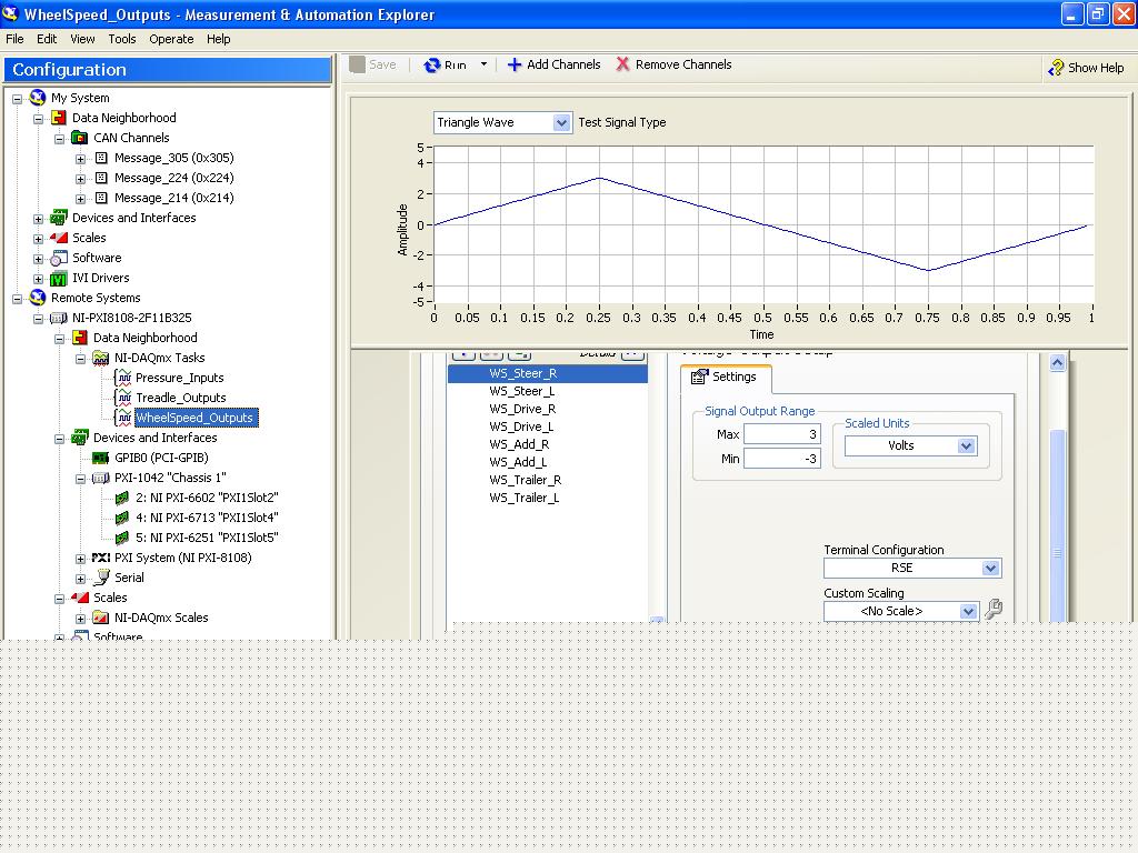

The bigger issue is  that I have a DAQmx task that I've set up for that channel.  I've set the output range in V, continuous samples @ 100 Hz for a triangle wave, and I'm not allowing regeneration.  When I click the run button for that task, I get a triangle wave, but the 30s, not 1/100s.

This was just in the test panel of the DAQmx task configuration window, not in any functional code.  I just clicked the "run" button at the top of the window, and then changed the values:
