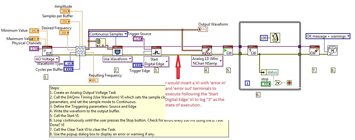

Two tips:
1) Add code to log the state of execution of the application to disk; for instance:
This will provide you with an "execution trace" of sorts as you will know exactly how much of the code executes on the second run (it may be hitting an error case and the error is just not getting logged).
2) Consider building a debuggable executable in order to utilize some of the built-in tools to debug the "launcher" VI (https://www.ni.com/docs/en-US/bundle/labview/page/debugging-applications-and-shared-libraries.html).
