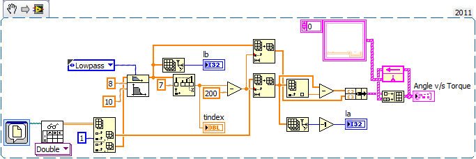

I have few real time data (this can vary from 2-15 maybe) from torque sensor for different runs. For analysis I need to plot the data overlapped and also trim it to the point so it starts at rising slope.The data are all in different files and the user may load these files one after the other. No of signals that will be overlapped is not fixed. In my program, the first signal, it works fine, it trims the signal and all.. From second file onwards, it does not trim and it seems to start from the previous signals last value...
tried various things. Attached are my Vis and jpeg.

Hi Patch,
you might restart the PtByPt-Filter function for each new signal using it's "Init" input…
Or use the "standard" (non-PtByPt) version of this filter!
