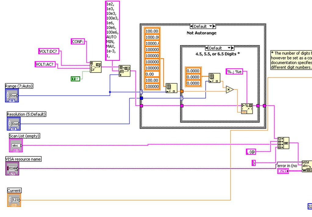

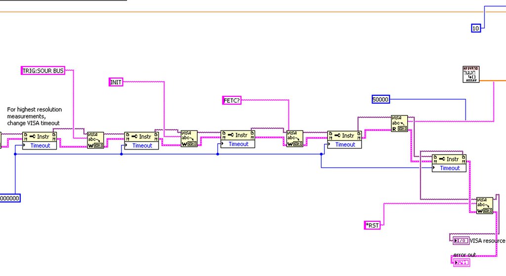

Here is what I am trying to do. But I get following two execution errors on the 34970A:
-420 : Query Unterminated
-113 : Undefined Header
Since the vi was long I am splitting the prtscrn into 2 parts:
Part 1:
Part 2:
Since I have never used the INIT, TRG, FETC commands I think am making mistakes in writing these commands to the instrument. Any help is appreciated.

You are making a mistake with the very first command. You are doing a CONF:VOLT AC? or VOLT:CONF:DC? Anytime you put a ? at the end, that's a query (your are requesting data from the instrument). You then issue another write without doing a read so the query is terminated. As I mentioned, I don't have access to the manual right now so look up in the manual for the proper syntax of configuring a scan list. It may be as simple as removing the '?'.
