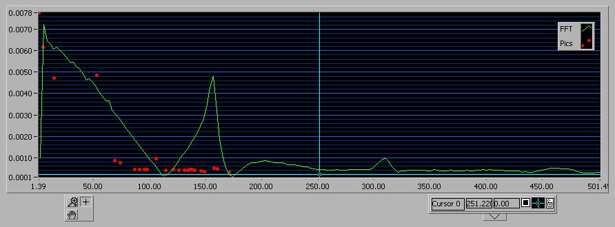

I've been trying to use the peak detector to determine the most present frequency in a frequency spectrum but I can't understant why there's a gap between the locations of the peaks that the peak detector returns and the actual peaks. Here is a picture that will make it clear :
Can you help me to fix it ? It'll be great to be able to use it...

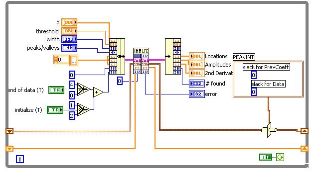

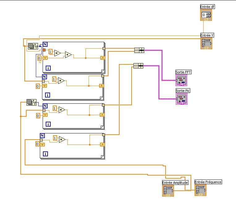

here's the code, i'm not sure you'll understand everything, but anyway, I checked I was using the same df or dt when I create the waveform signal (by the way is it the same thing for labview?), so I don't really understand. I tried (in the "PIC+FFT" subVI) to synchronize the curves using coefficients, but it didn't work.peak-finding-area.JPG
Peak finding area in my VI
"PIC+FFT" subVI shown upper
"Peak detector" code

This is an expected behaviour depending on the width input. Please read below extract from the help of Peak Detector.vi.
width specifies the number of consecutive data points to use in the quadratic least squares fit. width is coerced to a value greater than or equal to 3. The value should be no more than about 1/2 of the half-width of the peaks/valleys and can be much smaller (but > 2) for noise-free data. Large widths can reduce the apparent amplitude of peaks and shift the apparent location. For noisy data, this modification is unimportant since the noise obscures the actual peak. Ideally, width should be as small as possible but must be balanced against the possibility of false peak detection due to noise.

Using higher width obviously reduces the amplitude but doesn't change the location of the peaks, I just tried it, going up to 50 !
Have you got any other ideas ?

I have seen this before. And the problem is not the peak detector. It is a bug in your program. It looks like you do some timing operations on your signal like changing t0(this add some offset in time). If you forget to to the same on the peak locations the peaks will misplaced.

You were right, I was using a "wait" function in a while loop. Somehow, I don't really know why, it was causing a delay between the first and the second curve..., I deleted and it works now, :smileywink:
