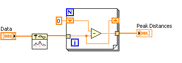

Yes, use a shift register.
The output of this will be an array of distances between peaks.
Edit: In my image, I have the values subtracting in the wrong order.
Just switch the wires leading to the subtraction function so the bottom wire is on top and visa versa

Hi thanks for your help,
It seems to be kind of working.  Except I'm inputting a sine wave with a period of 0.5 to 1 seconds and my answers are above 2 seconds.  Another problem I'm experiencing is my answers are disappearing on me.  The peak values counts down to zero and then the number is gone.  I think it has to do with my inputs.  I'm sampling multiple AIs using the DAQ assistant with continuous sampling.
Message Edited by Cory K on 06-11-2009 01:49 PM
If you have done a peak detection and found n peaks then you will have n-1 intervalsSmiley Tongue
