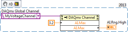

How exactly do I use/add the property node here? I was not able to add property node via the create option.

from the DAQMx Pallette drop a Channel node. then from the LabVIEW Help:
Analog Input:Maximum Value Property
Short Name: AI.Max
Property of DAQmx Channel
Specifies the maximum value you expect to measure. This value is in the units you specify with a units property. When you query this property, it returns the coerced maximum value that the device can measure with the current settings.
So My first answer was a slightly incorrect.  I just tried this and sure enough if i set AI.Max to 3.2, then read AI.Max it reads 5.  As 5V is the smallest range my particular device can use to read 3.2V
