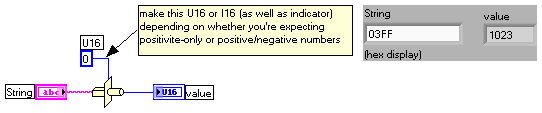

a can separate in a string , 8byts, whith 8bits !   (some experiences)           y     x
From the pic i´m sending 4 byts , 2 for eatch  ADC! a read something like (03 ;255) = 5V!
I have tried meny solutions but don´t seame very estable!tried numeric operations ......x+(256*Y)
how can i ad this two numbers to be with 1024 ?? am i going on a wrong way????

well what  i was triing to say ,was that a´m sending data from ADC .The ADC has a 10bit resolution!in serial comunication ,i can only send 8bits string.
if i want to read 10bit from ADC , i must send 2 byts ( 2x8bits) right ???
when ADC is reading ex: 5V he must have 1024 positions(10bits)!In Labview , i can read 2 byts the first(03), and the second (255).
I have tried to add this 2 byts in order to have  1024 ( 10 bits). Ex:
                                                           first byte (x)       second byte(Y)
                                                            (03)                    (256)                      X+(256xY)=result(1024)
this aplication works,but it doesn´t seme very stable!!!!
my question is :how do i add this 2 byts, or there is a more simple way!
am i taking a wrong direction???
I´m realy sory about my ingles!!
Message 17 of 39
(2,703 Views)
Yes.  You can use the join bytes function.  You wire in two U8 bytes and out comes a single U16 byte.
By the way, a byte can only go up to 255.  And if your first byte is the high byte of 03, then it is (X*256)+ Y = 3*256 + 255 =1023

A Type Cast would give you the same thing. Smiley Wink
Message 19 of 39
(2,691 Views)
Dohhh! Of course.
