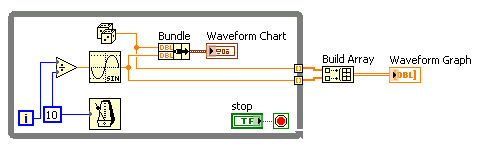

It seems that what you want is a either a Graph or a Chart with multiple plots. It's quite simple to do either of these. As said before, refer to the Context Help (Ctrl + H) from the block diagram terminal of the Chart or Graph to see how to add multiple plots. Here's a screenshot of how you would do it with a Chart and a Graph:
If you want to use different Y-scales for each plot, you need to create multiple Y-scales and then specify which plot uses which Y-scale:
I hope that this is explanation enough to get you started - otherwise, please let me know.

Thank you all! I've tried what you said, it works very well. Thank you so much.
