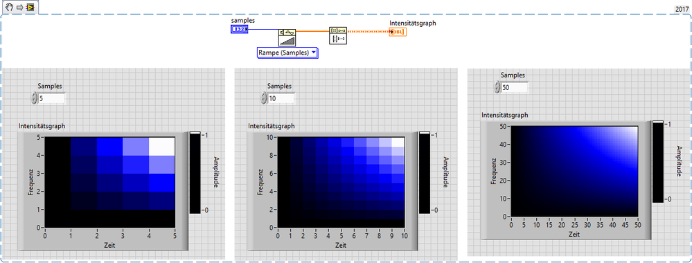

you need to acquire more than 5 measurements,
to render something like this goal.PNG ‏420 KB

>> I agree but if you look at the values in the X  and Y axis in the picture  are -4,-2,0,2,4.
Your code shows you are taking 12pts (4 steps in Vds and 3 Vgs for each Vds).  That's not nearly enough data points
The "goal" image is taking hundreds of steps between -4V and +4V, and a hundred steps in Vgs at each Vds.
So, increase the number of loops for both Vgs and Vds and you will start to approach the goal.  Start with 20 iterations each and see how it looks.  Having made measurements like the "goal" before you should know it can take many, many hours or even days to collect that much data!  Its a good idea to screen your device first to see if it works as expected before doing such a long term measurement.
