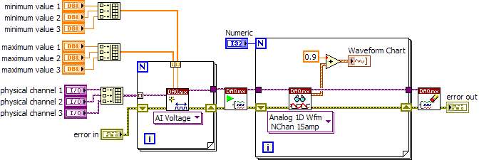

You need to change more that just the way you are plotting the data. You cannot run multiple analog in tasks. You can only have a single task but you can create a single task with multiple channels. Shown below is one way if you want to have separate min/max values for each channel. If you don't, just have a single DAQmx physical channel control with the multiple channels in it. The for loop can then be eliminated. I chose to use to return a 1D wavefrom type from the DAQmx Read NChan 1Samp and then just wire the output to a chart. If you want DBL returned it will be a 1D DBL array but you can't just wire the array to the chart. If you were to turn on Context Help, when you go to the block diagram and move your mouse over the chart indicator, it will show you the correct inputs for different types of charts. There is also a shipping example for charts that you can look at.

Sorry, I missed one thing. You should place a DAQmx Create Task before the for loop and wire it to the task in of the DAQmx Create Channel.
The reason you have two separate plots is that you chose the Stack Plots option. Right click on the chart and select Overlay Plots. The default is overlay so you had to have changed it yourself.

Hi Miaa,
attached is your vi, with the additional "create Task.vi".

Hi Miaa,
i´m not sure if i understand what you want. The left for loop is to configure your physical channels, so why should this loop run 400 times? You can remove the left for loop and insert three "Create physical channel" vi´s but why?
