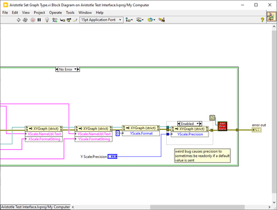

Apparently the default behavior of the Format property is readonly. I ran into this issue after upgrading to Labview 2022; the solution is to create a second property node for Display Format: Format and wire 0 as your value. This makes the property writeable again. Place this before any Display Format property, such as Format or Precision.
https://knowledge.ni.com/KnowledgeArticleDetails?id=kA00Z0000019Xq2SAE&l=en-US
Using Labview 2022, Windows 10
