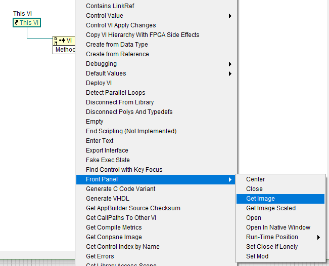

Here you can find it:
It is important that the Method Node has focus to the selected class "VI". You can force it by wiring a reference constant of "This VI" to the node or select it manually with context menu entry "Select Class" (reference input of method node must be unwired!)
Greets, Dave
