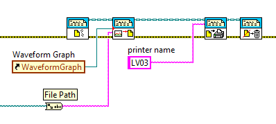

The TDMS Viewer is implemented as VIs, which are open to re-use and modification by users. If you're fine with just printing a bitmap of what the viewer displays, you can pretty easily do that by adding some code to the "Quit: (Value Change)" event in .\vi.lib\Utility\tdmsutil.llb\TDMS - File Viewer.vi:

Hi Herbert,
I followed it through, however when I press quit button nothing happens. I have chosen the print type as word file but on pressing quit, I think event structure is not executing. Is there's something I am missing
