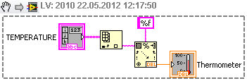

     In the attached VI,Iam giving temperature input from a string array,then converting it to binary and again converting to a decimal inorder to display in the thermometer.But while running it is giving incorrect values.what to do with this VI??

Where the temperature comes from and why is it in an array?
I'm not sure the code below is what you need, but what I'm pretty sure about is that you use too many conversion operation, only one should be enough.

Hi Tito,
          You have given a simple display.But Iam trying to pack them in a particular frame.That's why Iam trying to convert it to binary and then reconverting it and displaying.My VI works fine when Iam entering numbers below 10(Ah).So please give some suggestions in that way.

Sorry,
         I mean,when I enter 50.The thermometer indicates 80.That result is unexpected.Inorder to get 50 as 50,what have to be changed in the VI?

Hi Danil,
in your example VI you used (and always wanted to use, as is clearly written in the first message of you original thread as linked before) the function "Hexadecimal string to Number". Now you wonder why a string of "50" is converted to a (decimal) number of 80???
Come on, sometimes it really helps to read the context help for all the functions used, even for such a small VI...
